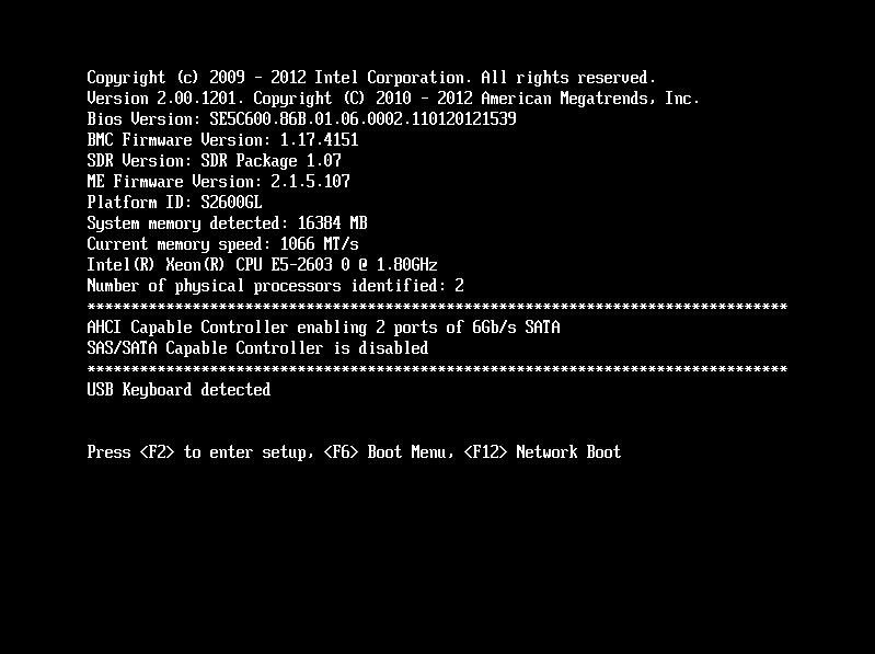

- On startup, the SecurID Appliance local console initially shows the RAID Controller BIOS version and RAID configuration information, as shown here:
- On the next screen, the administrator is given the option to press F2 to enter the setup.
- Press F2 to enter the setup.

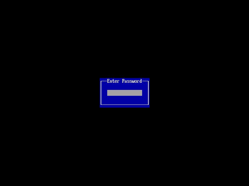

- You are prompted to enter a password. For example:

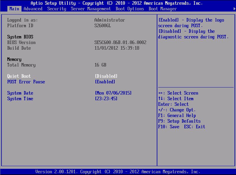

- After the BIOS password is entered, the BIOS menu is shown:

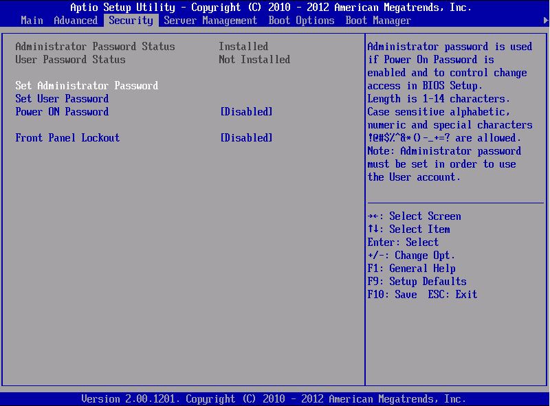

- Use the arrow keys on the keyboard to navigate the BIOS menu and select Security. For example:
- Select Set Administrator Password.
- Enter the current password for the BIOS.

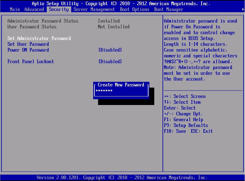

- Create a new BIOS password:

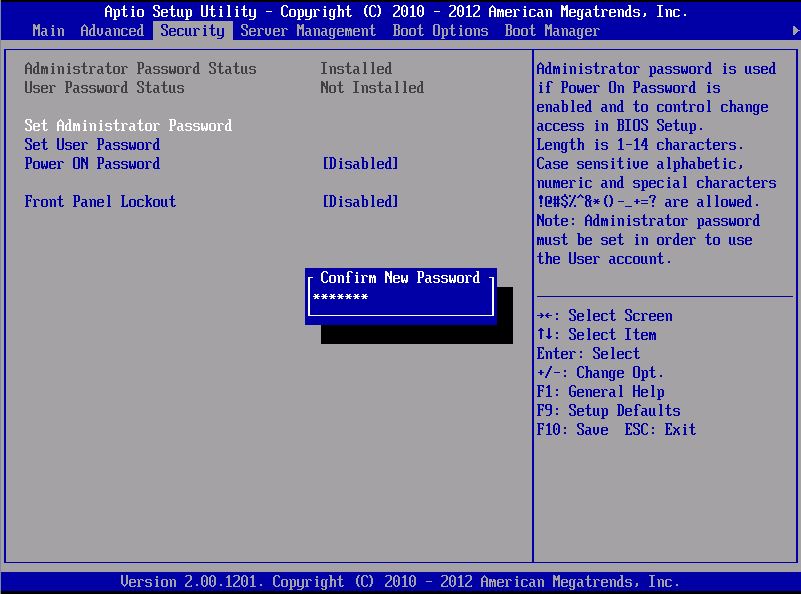

- Confirm the new BIOS password:

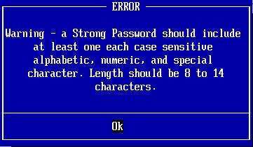

You may get the following warning if the password is not considered to be strong enough; however, the weak password is still accepted.
Use a strong password to ensure security. Store the new BIOS password in a secure place.

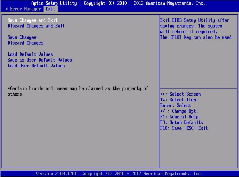

- After the BIOS password change, navigate the BIOS menu and select Exit. For example:
- Select Save Changes and Exit.
- When prompted select Yes to save the configuration and exit.
