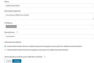

- Access your Cloud Administration Console and go to Authentication Clients > RADIUS.
- Choose your Authentication Details according to your needs and environment.

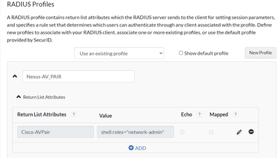

Click the Cloud Authentication Service validates password and applies access policy for additional authentication option for LDAP + RSA Authentication method and the Cloud Authentication Service only applies access policy for additional authentication option for only RSA authentication method. - Add new RADIUS profile with Cisco AVPAIR and set it according to the required role configured on the Nexus, for example, network-admin.
If you want to add multiple roles, you can separate them with space inside the “ “.
Note: you can change network-admin to any role you want according to what is configured on the Nexus, by default the network-admin role gives full read-write privileges on the switch.
