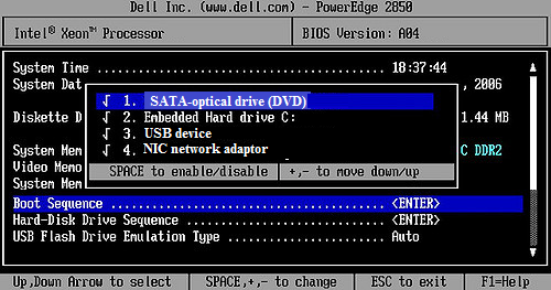

2. Verify the DVD/CD optical drive on the appliance
- Reboot the appliance with a monitor and keyboard physically attached so you can interrupt the boot sequence (typically with either the [F2] or [F11] key) and access the BIOS.
- Edit the BIOS boot sequence and move the internal SATA DVD/CD optical drive to the #1 boot sequence device. If it is already there, the drive may be bad. If it is not there, reboot and try again.
- If the internal DVD/CD optical drive is suspected to be bad, you can RMA the appliance. If you are in a hurry, try connecting a USB external DVD reader, make USB the #1 device in boot sequence in BIOS and try again.
