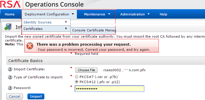

When importing a PKCS#12 SSL console certificate into the RSA Authentication Manager Operations Console, the import fails with a password error — even though the password is confirmed correct and the same file imports successfully in other tools.
Observable symptoms:
- Importing the .pfx or .p12 certificate file in the Operations Console produces the following error:
Your password is incorrect. Correct your password, and try again. - The same
.pfxor.p12file imports successfully into Internet Explorer using the identical password, confirming the password itself is not the issue. - The following key error is logged in /opt/rsa/am/server/logs/ops-console.log:

keytool error: java.lang.SecurityException: Algorithm not allowable in FIPS140 mode: PBE/PKCS12/SHA1/RC2/CBC/40 java.lang.SecurityException: Algorithm not allowable in FIPS140 mode: PBE/PKCS12/SHA1/RC2/CBC/40NOTE: The ops-console.log error reveals the true cause — the issue is not a wrong password but a FIPS 140-2 algorithm incompatibility. The Operations Console surfaces this internally as a password error, which can make this issue difficult to diagnose without checking the log.
The PKCS#12 certificate file was encrypted by the Certificate Authority (CA) using the RC2 algorithm (PBE/PKCS12/SHA1/RC2/CBC/40), which is not permitted in FIPS 140-2 mode. Authentication Manager operates in FIPS 140-2 mode by default and cannot process the file — but instead of reporting an algorithm error, the Operations Console surfaces it as a password error.
