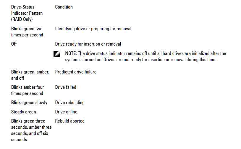

If you are noticing blinking lights on multiple hard drives, please make sure to replace only one drive at a time, replacing the failed drive first. Below diagram shows different indicator patterns on hard drives, based on the light color and the way it blinks.

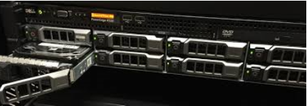

To replace the faulty HDD, you need to remove it from the bay slowly, wait for 10-12 seconds, add the new drive and wait for around 30 seconds after which server will recognize the new HDD and will start rebuilding automatically. This will be indicated by a fast flashing green light. Your storage software should show state of the drive as rebuilding.
