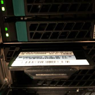

Dell models typically have a service tag is visible from the back, and Intel models have a pull-out tab on the front.
However, it is not always easy to get into the server room. This article provides administrators with a command that can be run remotely.

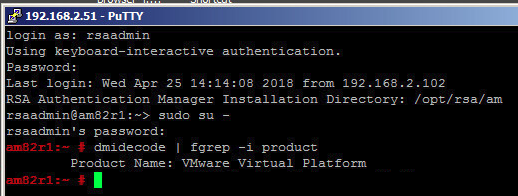

- Gain console access to the Linux operating system of your RSA Authentication Manager appliance, wither by SSH or direct console access.
- Gain root privilege.
- Run the dmidecode command and search for the hardware information.
- Gain console access to the Linux operating system of your RSA Authentication Manager appliance via SSH or direct console access.
- Escalate to root.
- Run the command dmidecode | fgrep -i product.
One or two lines should be displayed in the output, as shown above. Use the following table to determine the hardware platform for your appliance:
