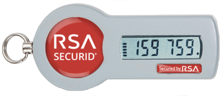

RSA SecurID Hardware Tokens
The SecurID 700 Authenticator easily connects to any key ring. The user simply reads the changing display (typically every 60 seconds) and uses it as part of a dynamic and always-changing password.
You can use this token with AM or Cloud Access Service (CAS). This hardware token generates and displays a new tokencode at a predefined time interval, typically every 60 seconds.
