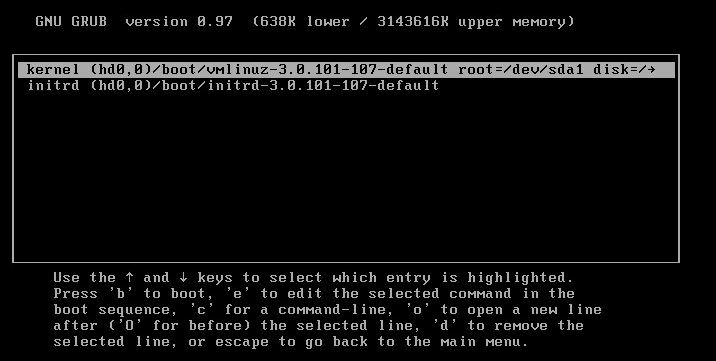

The problem arises if a customer with RSA Authentication Manager 8.2 SP1 applies a recent patch then uninstalls that patch and goes back and installs patch that is older than the recent patch that was previously applied. After installing the older patch, the system might not boot.
After installing a patch or upgrade which includes a update to the OS kernel, the system may fail to boot properly and report a message on the appliance system console immediately after the boot attempt, such as:
kernel (hd0.0)/boot/vmlinuz-3.0.1.1-108.18-default root=/dev/sda1 disk=/dev/saa vga-0x314 quiet Error 15: File not found Press any key to continue...
To complete this task,
- In the system boot, select the first item; that is, the normal boot and enter e to edit.
- There are two commands. Edit them both starting with the first. Highlight the line and enter e to edit.
- Move the text cursor back to the right of the -default string at the end of the kernel version and use the backspace key to delete the text which follows the version text. In the screen shots here, that would be 3.0.101-.
- Press the Tab key which should auto-complete the reference to the kernel correctly.
- Press the Enter key to save the updated line and return to the previous screen, then use the down arrow to highlight the next line.
- Edit this line in the same manner as the first. Again, finish with the Enter key to save.
- Press the up arrow to get to the first line then press b to boot with the updated bootstrap data.
